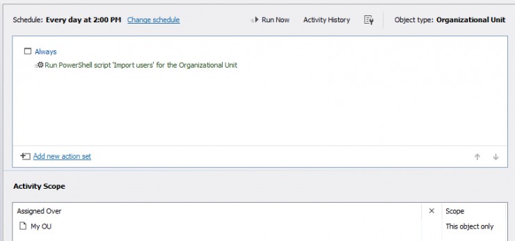

Thank you for the provided details. The script and the CSV file look correct. Could you, please, post here or send us (support[at]adaxes.com) a screenshot of the Scheduled Task you created with the Activity Scope? We need something like the following: image.png

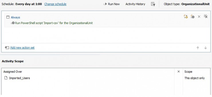

Hello Dario,
Thank you for the provided screenshot. The Scheduled Task looks correct. For the import to work, please, make sure that columns in the CSV file are separated by commas, not semicolons.

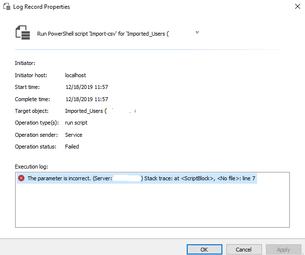

that solved the error but now I get a new one:
Thank you
Dario
Hello Dario,
Most probably, the error occurs because one of the values in the CSV file is not specified correctly. It should work fine with the properties displayed in the screenshot you provided earlier. Did you add new columns to the file? If so, please, make sure that the values in the columns are correct. For example, such an error can occur if you add the manager column to the CSV file and the values in the column are not distinguished names (DN).

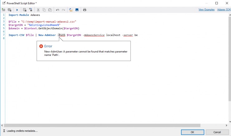

Well if I save the script i get a warning on exit and also inside the debugger I get an error on the -path parameter
Thank you
Hello Dario,
The script is correct. It is just that the cmdlet data is not loaded yet and that is why you get the error and the cmdlet parameters get underlined. You can see the data being loaded in the bottom left corner of the script editor.
