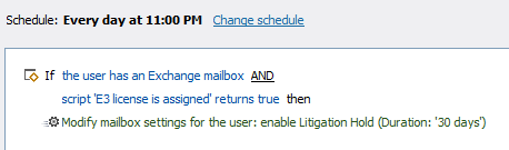

I was wondering if you can assist me with the following:
We are in the process of migrating user mailboxes from our on-premises Exchange to Exchange Online and we would like to create a script that runs nightly and checks for mailboxes that don't have litigation hold enabled and enables it. We have a mixture of licenses, E3 and F1, and from what I know, litigation hold can only be enabled for E3 licenses. Is there a way to filter that? I can then use the instructions found here https://www.adaxes.com/questions/1724/enabling-litigation-hold-while-provisioning-a-user for new users but again, can that be filtered per type of license?
You can use the Modify Exchange properties action described in the post you referenced in a Scheduled Task. To check whether a specific Office 365 license is assigned to an account, use the If PowerShell script returns true condition with the following script from our repository: https://www.adaxes.com/script-repository/check-whether-office-365-license-is-assigned-to-user-s322.htm. Finally, the Scheduled Task will look like the following: image.png

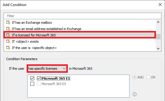

The script was removed as it is no longer required. There is a built-in condition allowing you to check whether certain Microsoft 365 licenses are assigned or not:
