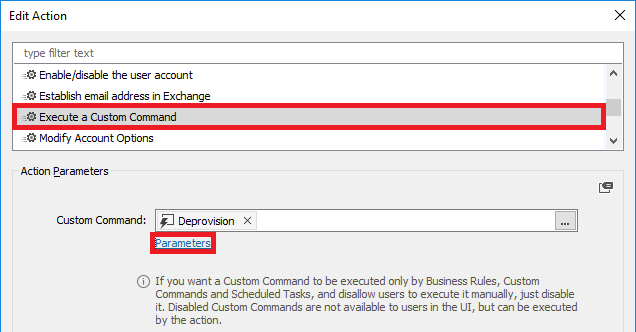

Hello Richard,
Sorry for the confusion, but it looks like you provided an incomplete script (the bind to Custom Command part is missing). Also, to execute a Custom Command on an object, you need to bind to it, not just obtain using the Get-AdmUser cmdlet. As we understand, the script is executed in a Custom Command, Business Rule or Scheduled Task where the user on which the Custom Command should be run is the target object. If that is correct, there is no need to use scripts, you can use the Execute a Custom Command action and use the Parameters option to specify parameter values: image.png
