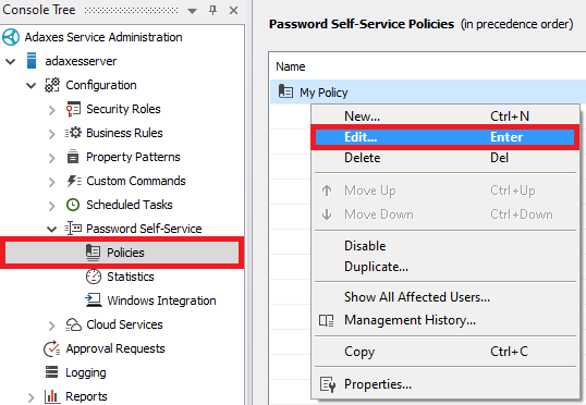

  3. Navigate to Configuration\Password Self-Service and select Policies. image.png
  4. In the Result Pane on the right, right-click the policy you need.
  5. In the context menu, click Edit.

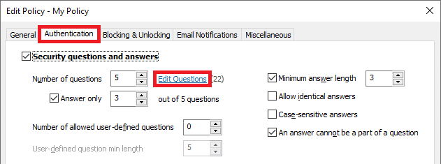

  6. Activate the Authentication tab.

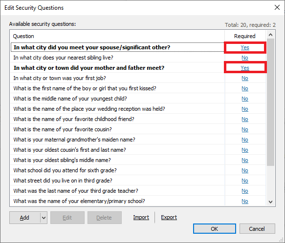

  8. In the Required column, change the value for mandatory questions to Yes. image.png
  9. Click OK twice.
