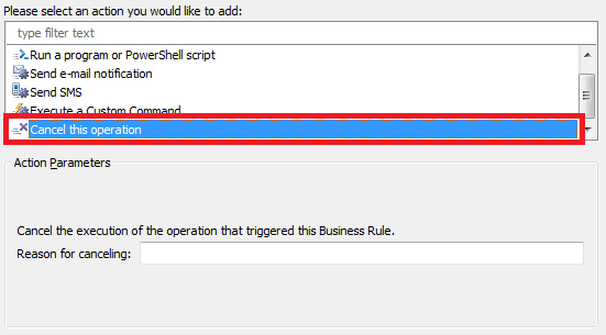

The necessary script is ready. To create a Business Rule that will cancel creation of a new user if a user account with the same ExtensionAttribute4 already exists:
  2. On step 2 of the Create Business Rule wizard, select User and Before Creating a User.
  3. On step 3, add the Cancel this operation action. Specify a reason for canceling, if necessary.
  4. Click OK.

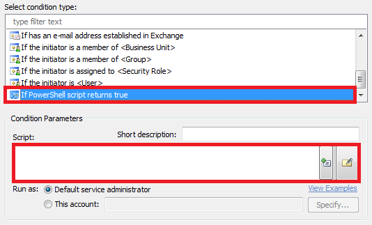

  5. Now, you need to specify when the Business Rule will cancel user creation. Double-click Always.
  6. Select If PowerShell script returns true.
  7. In the Script field, paste the following script that will return True if a user with the same ExtensionAttribute4 already exists:

  8. Enter a short description for the script and click OK.
  9. Finish creation of the Business Rule.
