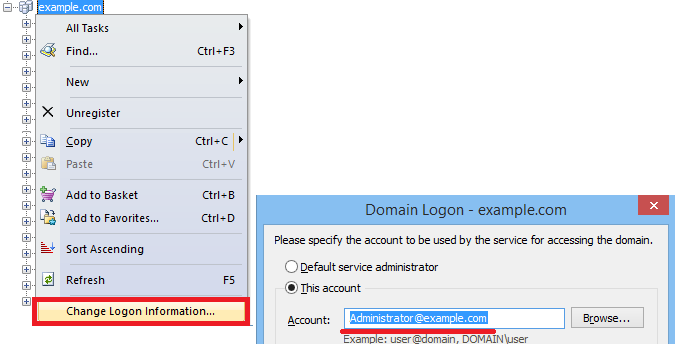

iii. Get the username of the account used by Adaxes to manage the domain where the issue occurs
To FInd out which account used to manage the domain in Adaxes:
  2. Navigate to the domain where the issue occurs
  3. Right-click it and select Change Logon Information. The account will be displayed in the dialog box that appears.
