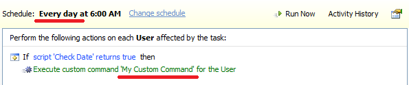

It is possible to use PowerShell to create a Scheduled Task that runs a Custom Command, however we have a better idea. As far as we understand, you already have the date when the Task should run stored in CustomAttributeDate3. Why not create a Scheduled Task that would run daily and execute the Scheduled Task for any users whose CustomAttributeDate3 is the same date as the current date? The task would look like this:
The script to use with the condition will be as follows:
    $decomissionDate = $Context.TargetObject.Get("%adm-CustomAttributeDate3%").Date
    return # No decomissioning date specified
$currentDate = [System.DateTime]::Now.Date
if ($decomissionDate -eq $currentDate)
