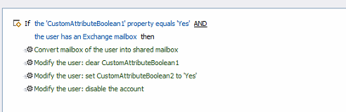

I then have a scheduled task that checks for the CustomAttributeBoolean1 and then runs the scheduled task with the below actions.

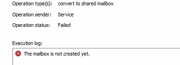

What I find is the task itself does work providing the mailbox has already been created. In otherwords if it runs whilst the mailbox is creating it will fail on the convert which is expected.
The below shows that the convert operation fails, however it still continues on with the rest of the actions. I know there must be somethign cunning to fix this, but I just cant seem to figure it out. I was thinking that there may be a way to only process the below actions if the previous one returned an Operation status of "Completed"

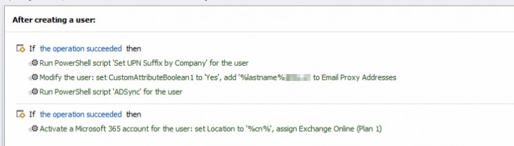

I create the mailbox using the below. Rule.
This all works just fine. Of course 365 takes some time to create the mailbox once the license is assigned.
If I left it longer to run the convert to shared mailbox schedulded task it all works as expected.
