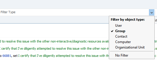

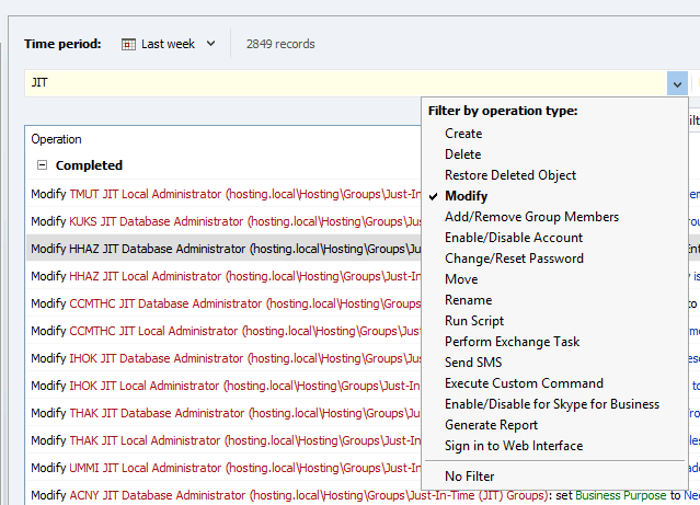

I'd like to create a custom Adaxes report based on the following Logging Filters -
I'm currently having to filter the logs manually each time I want to gather this data but am wondering if there's some way to build a custom report using these same filters?

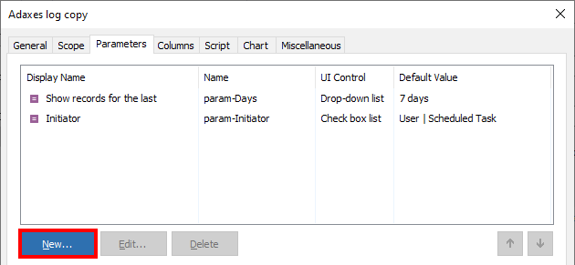

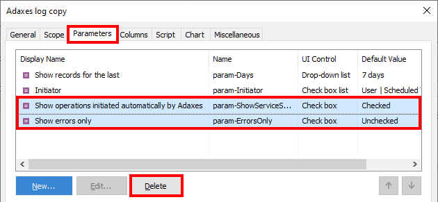

  6. Activate the Parameters tab.
  7. Delete the Show operations initiated automatically by Adaxes and Show errors only parameter. image.png

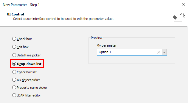

  10. Click Next.

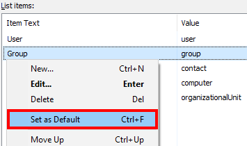

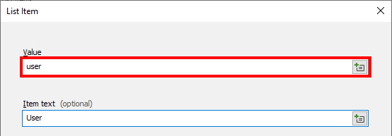

  14. Specify an object type (e.g. user for the User object type) in the Value field. image.png
  15. Click OK.
  16. Repeat steps 13-15 for all the object types that should be available for filtering in the report (e.g. group, contact, computer, organizationalUnit, etc.). If you want to specify an item as the default value of the parameter, it can be done via the Set as Default option in the item context menu: image.png

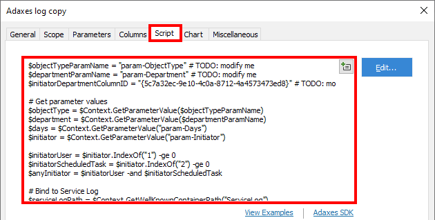

  18. Activate the Script tab.
  19. Paste the below script into the corresponding field. In the script, the $objectTypeParamName variable specifies the name of the parameter entered on step 11 with the param- prefix. image.png

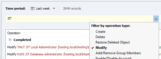

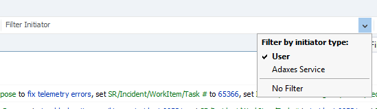

I followed the steps provided but the report it generates does not filter by Operation Type (Modify) + the additional 'JIT' filter. (See screenshot)
How would I incorporate those filters as well?

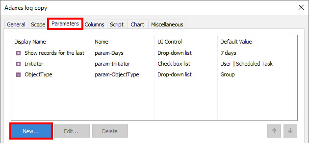

  5. Activate the Parameters tab.
  8. Click Next.

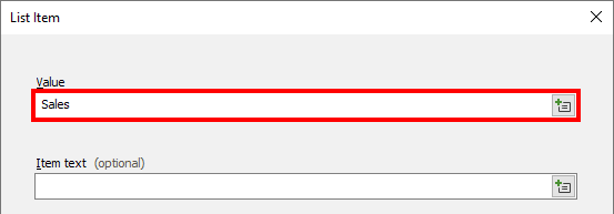

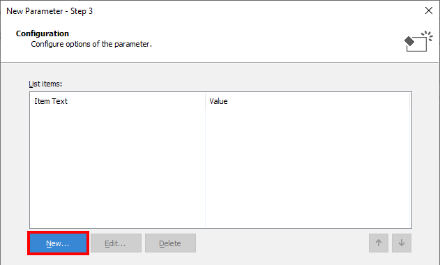

  13. Click OK.
  14. Repeat steps 11-13 for all the departments that should be available for filtering in the report.

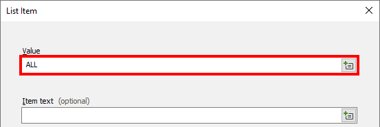

  15. Click New.
  17. Click OK.

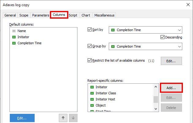

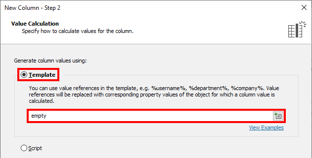

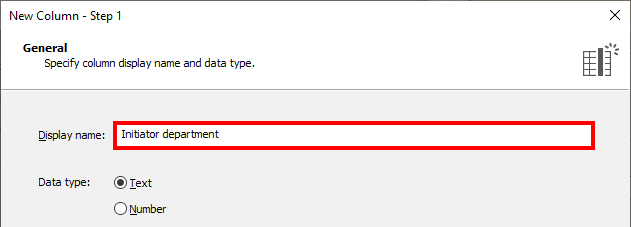

  19. Activate the Columns tab.
  21. Specify a Display name for the column (e.g. Initiator department). image.png
  22. Click Next.
  23. Select Template.
  24. In the field below, enter a default value (e.g. empty). The value will never be present in the report and is only required to create the custom column. image.png
  25. Click Finish.

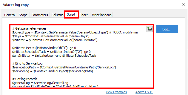

  26. Activate the Script tab.
  27. Paste the below script into the corresponding field. In the script, the following variables were added:
    • $departmentParamName – Specifies the name of the parameter entered on step 9 with the param- prefix.

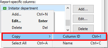

    • $initiatorDepartmentColumnID – Specifies the identifier of the custom column that will display the initiator department. To get the identifier:
      1. On the Columns tab, right-click the custom column.
      2. In the context menu, navigate to Copy and click Column ID. image.png The identifier will be copied to clipboard.
$objectTypeParamName = "param-ObjectType" # TODO: modify me
