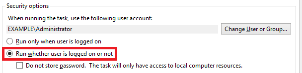

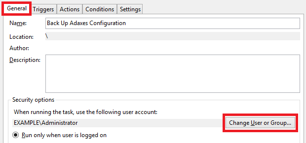

Yes, actually, Windows Task Scheduler allows specifying the credentials that will be used to run a scheduled job. The job will be run as if the specified user is logged on to Windows. The credentials will be stored securely by Windows, and there will be no need to specify them via the command line. To specify the credentials:
  1. On the General tab of the Create Task dialog, click Change User or Group under Security options.
  2. In the dialog box that appears, select the account of Adaxes default service administrator.
  3. Activate the Run whether user is logged on or not option.
  4. Specify all the other parameters of the task.
  5. When saving the task, you will be prompted for the password of the account that you've specified.

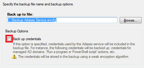

Actually, the issue would occur anyway, no matter how you start the backup process: manually or via a scheduled task. It occurs when FIPS compliance validation is enabled and you chose to include credentials in the backup file. The thing is that the credentials are included in encrypted form. To encrypt the credentials, standard .NET Framework encryption mechanisms are used, however they are not compliant with FIPS. We are already aware of the issue, and a fix will be included in the nearest release.
To work around it, you can:
  • Not include the credentials in the backup file. In this case, after restoring Adaxes configuration, you'll need to manually re-enter all credentials used by Adaxes service. This includes credentials for managed domains, credentials used to run PowerShell scripts via the Run a program or PowerShell script action, and credentials for your Office 365 Tenants. For this purpose, disable the Back up credentials option on step 2 of the Backup/Restore Adaxes Configuration wizard.
