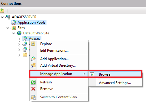

Thank you for clarifying. For troubleshooting purposes, please, do the following on the new server:
  1. Launch Internet Information Services (IIS) Manager.
  2. In the Connections pane, expand the server that hosts Adaxes Web Interface and then expand Sites.
  3. Expand the web site that hosts Adaxes Web Interface.
  4. Right-click the Adaxes virtual directory.
  5. In the context menu, navigate to Manage Application and then click Browse. image.png
  6. Does it work fine?

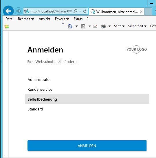

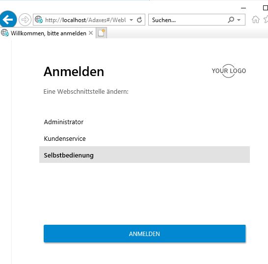

After that we get follwing resultbrowsing the application in IIS: Old server: Browse-old-server.jpg New server: Browse-new-server.jpg
As you can see there is one Webinterface listed on the old one that isn't on the new one. There are 3 more on the old server that can be accessed, but are not listed (on neither server).

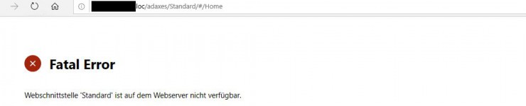

Accessing the webinterface "Standard" on both servers: Old server: Standard-old-Server.jpg New server: Standard-new-Server.jpg
It looks the same for other webinterface (e.g. Laufwerk or Controlling) .

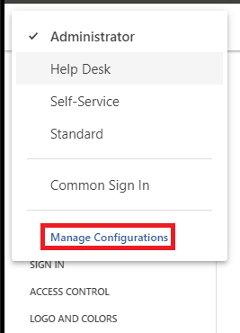

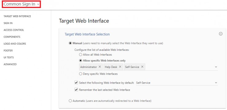

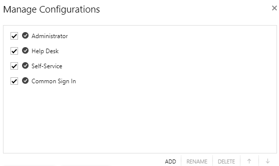

Could you, please, post here or send us (support[at]adaxes.com) a screenshot with the list of available Web Interfaces and a screenshot of the Web Interface selection settings on both (old and new) servers? To take the screenshot:
  2. Expand the drop-down menu in the top left corner and click Manage configurations. image.png
  3. Take a screenshot. We need something like the following: image.png
  4. In the top left corner, select Common Sign In from the drop-down menu.
  5. Take a screenshot. We need something like the following: image.png

Thank you for the provided screenshots. According to them, all the Web Interfaces are enabled in both configurations. Most probably, specific Web Interfaces (e.g. Standard) are not allowed on the new server. For example, they can be configured to be available only on the old server and thus the Common Sign In page on the server displays them as expected. For information on how to check\change the setting, have a look at the following tutorial: https://www.adaxes.com/tutorials_WebInterfaceCustomization_DisableWebInterfaceOnWebServers.htm.
by (50 points)
Thanks for your help. I don't know why the webinterfaces had been set only for this server, as we always had only one.
But, most important, this solved our problem!
