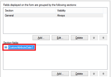

i. Create Home Page Action for setting the separation date
For information on how to create a Home Page Action that allows modifying a user, see Configure Home Page Actions, section Modify Object. On Step 4 of the section, you will find instructions on how to modify the form used by the action. You need to remove everything. Then, you'll need to add a property that will be used to pass the separation date, for example, CustomAttributeDate1.

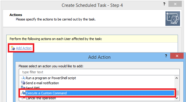

  2. On the 3rd step of the Create Scheduled Task wizard, select User.

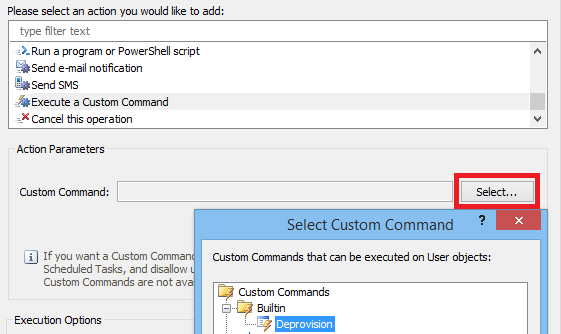

  3. On the 4th step, click Add Action and select the Execute a Custom Command action.
  4. In the Action parameters section, click Select and select the Custom Command you need.
  5. Click OK.

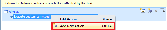

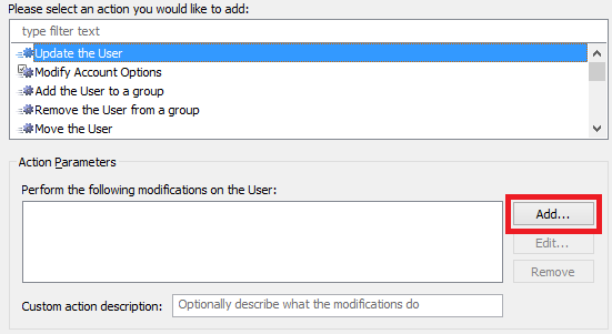

  6. Now, you also need to add an action to clear the custom attribute that is used to specify the deprovision date. This is needed to avoid processing the same user again. Right-click the action and select Add New Action.
  7. Select Update the User and click Add.

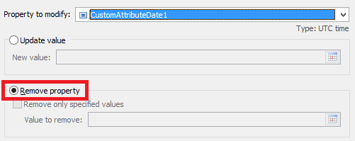

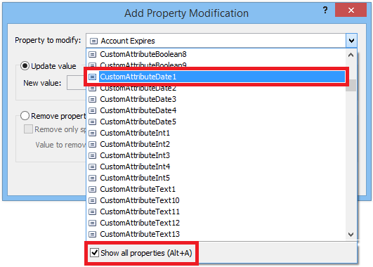

  8. In the Property to modify drop-down list, select Show all properties.
  9. Select the property that is used to specify the deprovision date, e.g. CustomAttributeDate1.
  10. Switch the radio button to Remove property.
  11. Click OK 2 times.

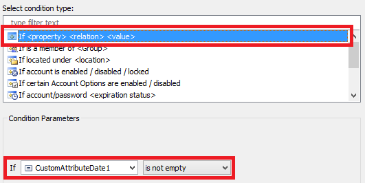

  12. Now, you need to specify when a user must be deprovisioned. First of all, the property that is used to specify the deprovision date must not be empty. Right-click the action you've just added and select Add Condition.
  13. Select the If <property> <relation> <value> condition type.
  14. In the Condition parameters section, specify If CustomAttributeDate1 is not empty:
    • where CustomAttributeDate1 is the property that is used to specify the deprovision date.
  15. Click OK.

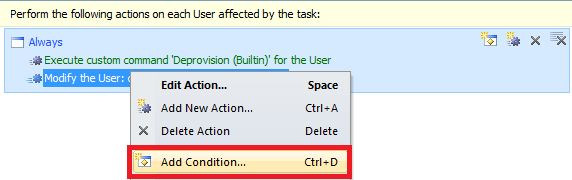

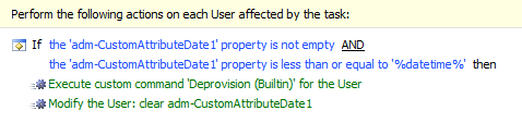

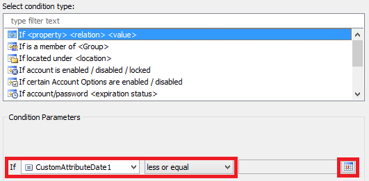

  16. Also, the date when a user must be deprovisioned must be less than or equal to the current time. Right-click the action and select Add Condition again.
  17. Select the If <property> <relation> <value> condition type.
  18. In the Condition parameters section, specify If CustomAttributeDate1 is less then or equal.

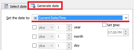

  19. Click the Edit button embedded in the Value field.
  20. Activate the Generate date tab.
  21. Select Current date/time.
  22. Click OK 2 times. You should receive something like this:
