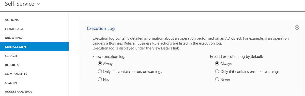

Is this still possible in 2019.1? I'm trying this but unable to see any output when I'm setting the LogMessage to Information. If I use Warning or Error it outputs, but this makes the end-user think there was a problem. I can see the information log output if I go into the administration console and logging, but there is no output in the web interface after the end user triggers the custom command.
by (920 points)
Answered my own question! Found the following settings in the web interface configuration tool. Changed from default of "only if it contains errors or warnings" to "always". Hope this helps someone else!
