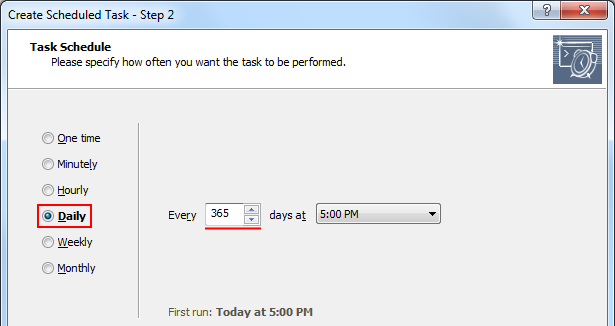

You can achieve that by creating a Scheduled Task that will be executed every 365 or 90 days:
  1. Create a Scheduled Task.
  2. In the Task Schedule page, select Daily.
  3. Specify Every 365 days or Every 90 days.
looks good but if I understand correctly this will execute the report 365 days after the initial date the task was created but I need to have it send for example on December 31 each year or quarterly, meaning March, June, September, December
