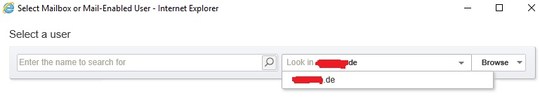

we have a forest with two trees that hold one domain each. There is a default tree-root trust (transitive, two-way) between the top domains. Since both trees are in the same forest they share the same global catalog and schema. The relevant exchange mailboxes and most users are held in the forest root domain (lets call it tree-root-1). Less then 5% of the users are held in the other tree-root domain (lets call it tree-root-2).

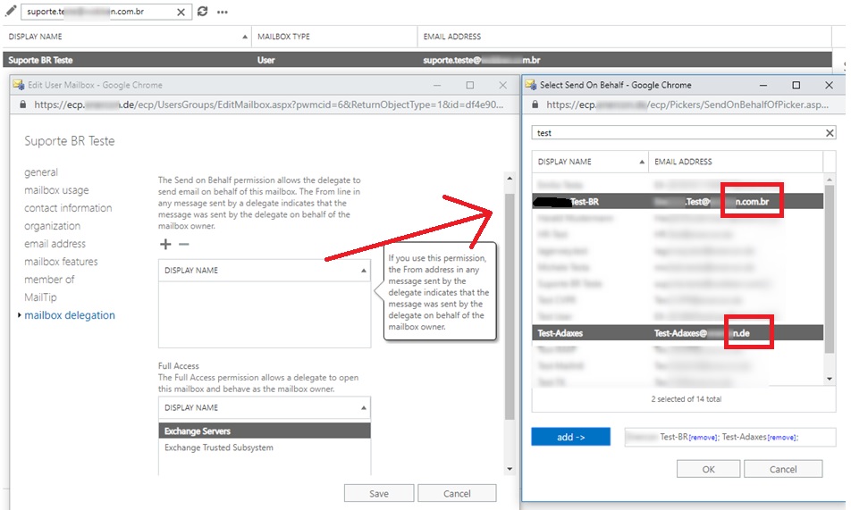

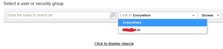

We configured a button in Adaxes to manage the "Send on behalf of" and "Full Access" properties in Exchange. We used the built-in functionality from Adaxes. The buttons work fine. there is just one problem: If we try to give a user from tree-root-2 "Send on Behalf of" permissions to a mailbox in tree-root-1 we fail, because the 'Look-In" box in the web interface will not allow us to choose anything but tree-root-1 (the forest root domain). When using the "Full-Access" button the "Look-In" box allows us to chose between "Everywhere" and tree-root-1.
Please also see the two attached pictures.
Where can we configure the "Send on Behalf of" function to also use "Everywhere" in the Look-In box?

Hello Harry,
The Send on behalf privilege can be granted only to the users located in a domain that has parent-child Trust Type with the domain of the user being updated. Unfortunately, there is no other possibility. This is an Exchange restriction, not Adaxes.

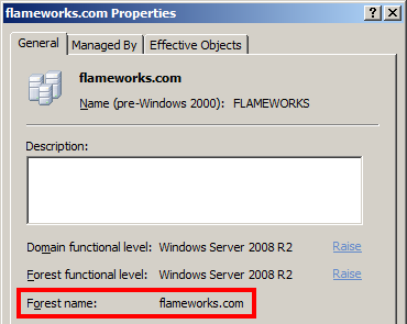

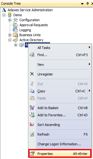

Sorry for the confusion. Could you, please, confirm that the values of the Forest name field in the properties of the domains registered in your Adaxes service are same? To check the values:
  2. In the Console Tree, expand your Adaxes service node.
  3. Expand Active Directory section.
  4. Right-click the domain which should be checked.
  5. In the context menu, click Properties.
  6. On the General tab, check the value of the Forest name field.
by (270 points)
Hello Support,
I just checked our system. We have two domains listed under "Active Directory" and they both show the same forest name in "Properties of..."

Hello Harry,
Thank you for your patience. It looks like the tree-root-2 domain is not displayed because the logged on user does not have the permissions to see it. By permissions here we mean those granted by Adaxes Security Roles, not native Active Directory permissions. For details, see https://www.adaxes.com/tutorials_Delega ... mUsers.htm.
To remedy the issue, you should grant the Allow Read All object types permission to the user over This Domain object and check if there are no Deny permissions. For information on how to view Security Roles assigned to user, have a look at the following help article: https://www.adaxes.com/help/?HowDoI.Man ... forms.html.

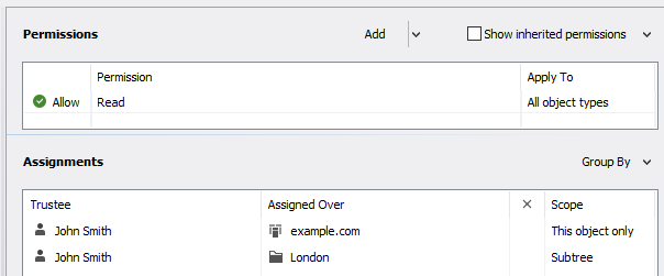

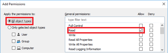

Hello Harry,
As long as you need to grant the permissions to not only see the domain itself, but also specific objects located in it (users that will be set in the Send on Behalf permission), the Security Role you need will look like the following:
In the dialog for adding the permissions, you need to select the type objects and then select the Read permission in the Allow column in the general permissions section.
