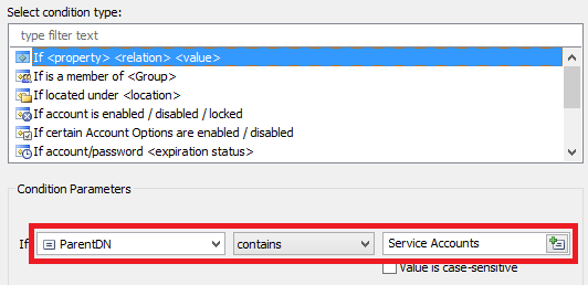

Actually, instead of using a script, you can use the ParentDN property. This is a constructed (virtual) property that returns the Distinguished Name (DN) of the container or OU where an object is located.
Thus, for your task, you can check whether the DN contains Service Accounts. Checking whether the user is already a member of the group is also a good idea. Thus, the actions/conditions of your Scheduled Task will look as follows:
To add, such actions/conditions to your task:

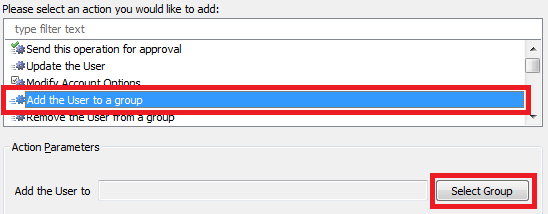

  1. Add a new action to your Scheduled Task.
  2. Select Add the User to a group.
  3. Click Select Group and specify the necessary group.
  4. Click OK 2 times.
  5. Add a condition.
  6. Select the If <property> <relation> <value> condition type.
  7. In the Condition Parameters section, specify If ParentDN contains Service Accounts.
  8. Click OK.

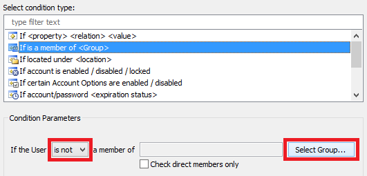

  9. Add another condition. Select the If is member of <Group> condition type.
  10. Select is not.
  11. Click Select Group and specify the necessary group.
  12. Click OK 2 times.
