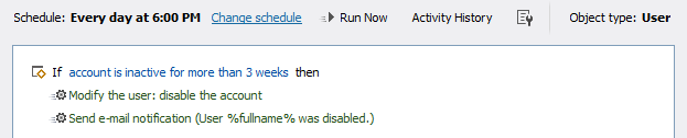

Unfortunately, it is not possible to check whether a user is inactive for a specific number of days. It can only be done for a number of weeks. As we understand, you need the scheduled task to disable inactive users and then send an email notification for each of them. In this case, the scheduled task should look like the following: image.png If this is not what you need, please, describe the desired behavior in all the possible details with live examples.

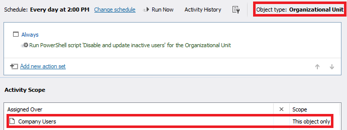

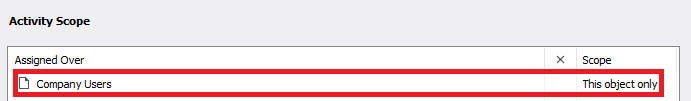

Here is a screenshot of the task. 2021-04-01_9-08-02.png Here is an example of the Active Directory structure. I will get an email for each department inside location 1, then i will get an email that combines all of location 1 then i will get an email for each department inside location 2 and an email that combines all of locaton 2 once it reaches the last OU it will send an email that has every department at every location combined. 2021-04-01_9-09-30.png
The behavior occurs because the scheduled task is assigned over the Company users OU subtree, not the OU itself as it was shown in the post where we shared the initial script. To achieve the desired:

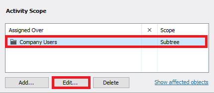

  4. In the Activity Scope section on the right, select Company Users and click Edit below. image.png

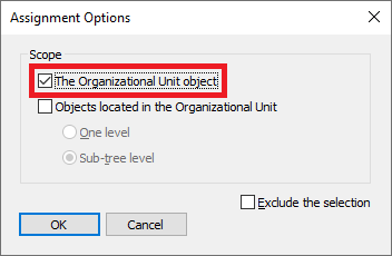

  5. Select the The Organizational Unit object checkbox.
