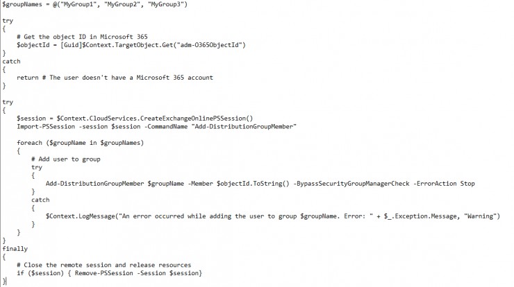

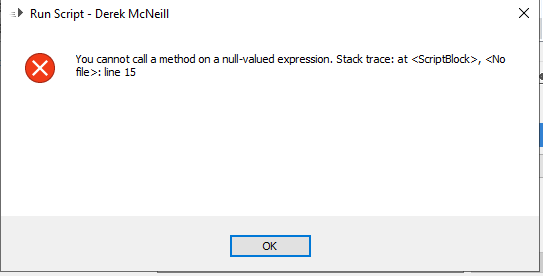

I have tried using this Powershell script but it gives me this error image.png
by (40 points)
The script can only be used in Adaxes 2021.1. Use the below script instead. For the script to work, install the Exchange EXO V2 module on the computer where Adaxes service runs.
Import-Module ExchangeOnlineManagement
$groupNames = @("MyGroup1", "MyGroup2", "MyGroup3")
    # Get the object ID in Microsoft 365
    return # The user doesn't have a Microsoft 365 account
Connect-ExchangeOnline -Credential $Context.GetOffice365Credential()
foreach ($groupName in $groupNames)
    # Add user to group
        Add-DistributionGroupMember $groupName -Member $objectId.ToString() -BypassSecurityGroupManagerCheck -ErrorAction Stop
        $Context.LogMessage("An error occurred when adding the user to $groupName group. Error: " + $_.Exception.Message, "Warning")
