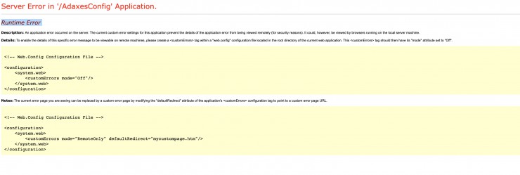

The error occuren when we try to access Adaxes and AdaxesConfig web interface. The native app works fine.

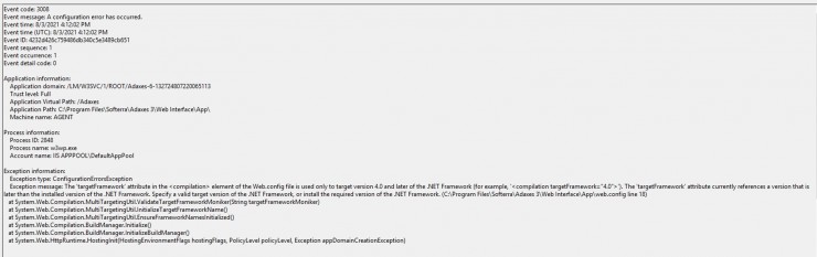

And here is the event log
Thank you for the provided details. First of all, please, make sure that ASP .NET 4.7 or 4.8 is enabled in section Turn Windows Features On or Off. You can directly access it by typing the section name in the Windows Start menu. If it is enabled, try re-installing the feature.

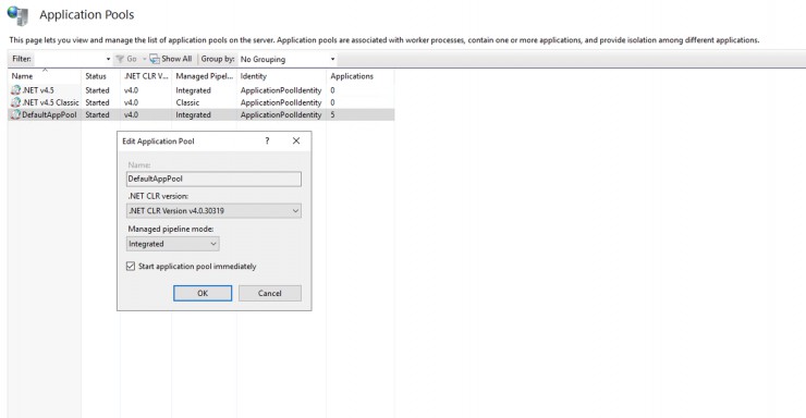

What I don't understand is the application pool settings available
But the framework is correctly reported on the system:
