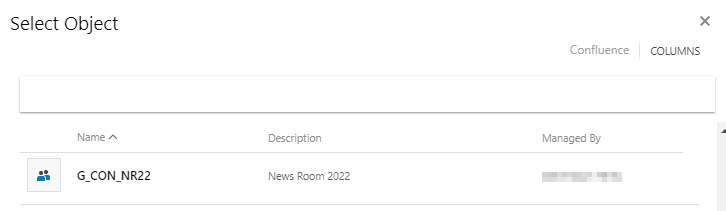

The search function in the AD object picker seems to be limited to the attribute "Name".
I have some AD groups where the name is not very meaningful for our employees. Searching by description would be very helpful in these cases.
Is there any way to include the "Description" attribute in the search?
Pudong
by (680 points)
Hello Pudong,
Unfortunately, there is no possibility to add attributes to the list for search. However, thank you for the suggestion. We forwarded it to the corresponding department for consideration.
