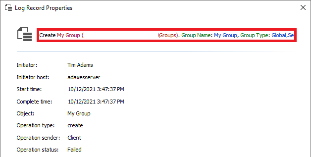

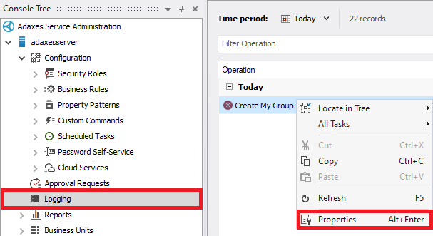

The error is returned by Active Directory (you can see it from the error containing the server name) which means that some requirements are not met. It looks like you are not changing the sAMAccountName which must be unique. To be sure about the root cause of the issue, you can do the following:
  3. Select Logging.
  4. In the Result Pane on the right, right-click the log record for the failed group creation.
  6. Select the entire operation description, copy and then paste it to a text editor. image.png
  7. You will see all the properties being set for the group creation.

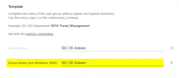

Hi Support,
Thanks for the tip, this allowed me to locate the problem. After I have expanded the form (yellow), the group can be copied. image.png
However, the user does not need to see this.

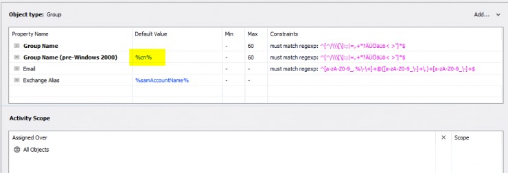

We have property patterns for groups: image.png

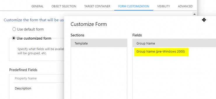

Best regards Johann
Hello Johann,
Unfortunately, if you just remove the Group Name (pre-Windows 2000) property from the form the property pattern will not work. The property value will be copied from the source group and you will keep getting the error message.

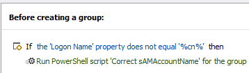

As a workaround, you can remove the property from the form and create a business rule triggering Before creating a group. The rule will check whether the Group Name (pre-Windows 2000) property value equals that of the Group Name property and if not, execute the below script to update it accordingly.
# Get group name
$groupName = $Context.GetModifiedPropertyValue("cn")
# Remove spaces
$groupName = $groupName.Replace(" ", "")
# Update group samAccountName
$Context.SetModifiedPropertyValue("sAMAccountName", $groupName)
Finally, the rule will look like the following: image.png
