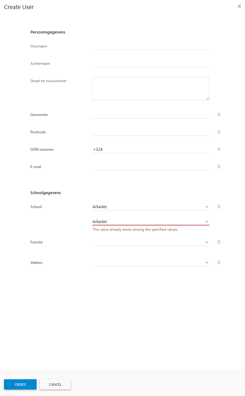

I have made a property with adm-CustomAttributeTextMultiValue3 and named it "School". Then I have added the values Arkades, BSLA, BSLG, BSLH, LCA, LCB, LCG, LCH in the selection"Must be one of the following values only":. Here you can see a screenshot of it:
Now when I create a user, I can select the values without any problem. But when I try to select two times the same value, it gives me the following warning: "This value already exists among the specified values.". How can I disable that? It must be possible to use for example two times the value "Arkades". Here you can see an screenshot of the warning:
Can anyone help me to fixs this problem?
by (120 points)
Unfortunately, there is no possibility to select the same value multiple times for a multi-value property. This behavior is by design.
As a solution, you can use multiple attributes (not necessarily multi-value) with the same list of allowed values. In this case, you will be able to specify the same values for the attributes.
