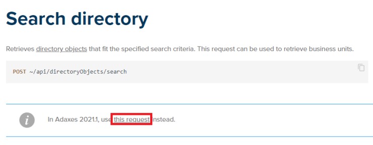

And yes while the documentations does say what you have there, it's just not true for the older versions. Since there is a limit of 1000, it should state that.
That is not correct. There is a link to the article for version 2021.1 in the beginning of the Search directory article. image.png
How do you make multiple requests to eventually get ALL of the members of a group over 1000.
The approach is totally up to you. For example, you can first get members whose name starts with A, then with B, etc.
