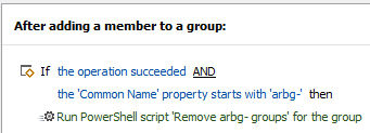

It can be done using a business rule triggering After adding a member to a group and the below PowerShell script. The rule will look like the following: image.png
$filterPart = [Softerra.Adaxes.Ldap.FilterBuilder]::Create("distinguishedName", "%distinguishedName%")
$searcher = $Context.BindToObject("Adaxes://%member%")
$searcher.SearchFilter = "(&(objectCategory=group)(name=arbg-*)(!$filterPart))"
$searcher.SearchScope = "ADS_SCOPE_BASE"
$searcher.PageSize = 500
$searcher.AttributeScopeQuery = "memberOf"
    # Execute search
    $searchIterator = $searcher.ExecuteSearch()
    $searchResults = $searchIterator.FetchAll()
        $group = $Context.BindToObjectBySearchResult($searchResult)
        $group.Remove("Adaxes://%member%")
    # Release resources
    if ($searchIterator){ $searchIterator.Dispose() }
by (590 points)

Here is the updated script using criteria instead of the LDAP filter.
# Build criteria
$criteria = New-AdmCriteria "group" -Expression {(name -startsWith "arbg-") -and (distinguishedName -ne "%distinguishedName%")}
# Search parameters
$searcher.Criteria = $criteria
    # Execute search
    # Release resources
