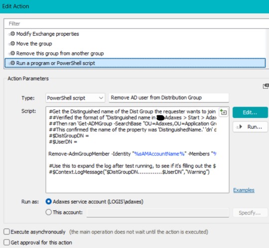

I was looking for some assistance with this command. I can not get this command below to work. I have tried two ways, and neither removed the account from the specified group. I've tried the group Distinguished name as well for Identity.
Remove-AdmGroupMember -Identity "%sAMAccountName%" -Members "%adm-InitiatorDN%" -confirm:$false -AdaxesService localhost
#$DistGroupDN = "%sAMAccountName%"
#$UserDN = "%adm-InitiatorDN%"
Remove-AdmGroupMember -Identity "$DistGroupDN" -Members "$UserDN" -confirm:$false -AdaxesService domain.com

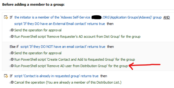

Where are you executing the script? Is it in Windows PowerShell or in Adaxes? If it is in Adaxes, please, post here or send us (support@adaxes.com) a screenshot of the custom command, business rule or scheduled task executing the script.
by (550 points)
I've got it in a Business Rule as an action under an Else if condition. The other two actions work without issues.
Thank you for the provided details. The first approach should work fine, but it might be required to add the -Server parameter:
Remove-AdmGroupMember -Identity "%sAMAccountName%" -Members "%adm-InitiatorDN%" -confirm:$false -AdaxesService localhost -Server "dc.domain.com"
Also, you can use the below approach that will definitely work.
$Context.TargetObject.Remove("Adaxes://%adm-InitiatorDN%")
by (550 points)
The top script with "-Server" specified did the trick.
I will keep your bottom script in the back of my pocket.
Thank you!!!
