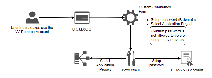

Hi. I am create a Custom Commands. The Custom Commands will run a powshell by user.
Is it possible for me to require the user to verify the passwordagain when performing these Custom Commands?
by (90 points)
Sorry for the confusion, but we are not sure what exactly you mean. Could you, please, describe the desired behaviour in all the possible details with live examples?
by (90 points)
Hi I use Custom Commands to let users set B domain passwords. User is login Adaxes use A Domain. We do not allow users to set the same password as "A domain"
I tried to verify "A DOMAIN" by entering the password to confirm whether the password is the same
Thank you for the provided details. Unfortunately, there is no possibility to validate passwords the way you need because Active Directory does not allow retrieving passwords of existing users. This behaviour is by design and is not related to Adaxes.

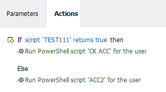

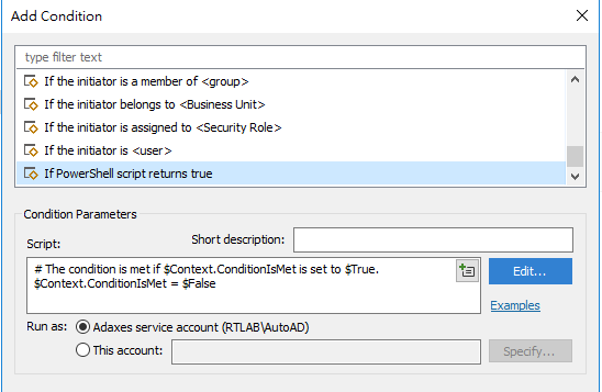

Thanks for your reply, I did it using the method below. share with everyone.
# The condition is met if $Context.ConditionIsMet is set to $True.
$UserName = '%sAMAccountName%'
$Password = '%param-P01%'
Function Test-ADAuthentication {
    param(
        $username,
        $password)
    (New-Object DirectoryServices.DirectoryEntry "",$username,$password).psbase.name -ne $null
$condition = Test-ADAuthentication -username $UserName -password $password
if ( $condition)
Thank you for sharing the details. We misunderstood your requirement. If the password to validate is provided (e. g. in a parameter like you did) it is certainly possible to validate the credentials.
