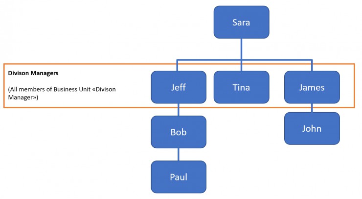

Hello I have created a business unit in Adaxes called "Division Manager" which contains all AD users that have the function Division Manager.
For example, I want to know the division manager from Paul. To get the Division Manager from Paul, his manager must be checked to see if he belongs to the Business Unit "Divison Manager". If this is not the case, the next higher manager is checked until the correct manager is found (Jeff).

Thank you for the provided details. As we understand, first the script should check the manager of the member being added to the group, then manager of the manager and so on until a manager that is a member of the specified business unit is found. Is that correct? If it is, please, specify what should be done in case if somebody in the chain does not have a manager or there is no manager belonging to the business unit found.
by (680 points)
Yes, that is correct.
