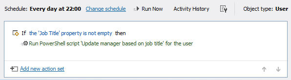

Thank you for clarifying. To achieve the desired, use the following script from our repository: https://www.adaxes.com/script-repository/set-manager-based-on-property-value-s670.htm. In your case, it should be executed in a scheduled task like the following: image.png

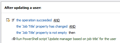

Also, you can use the script in a business rule like below: image.png
