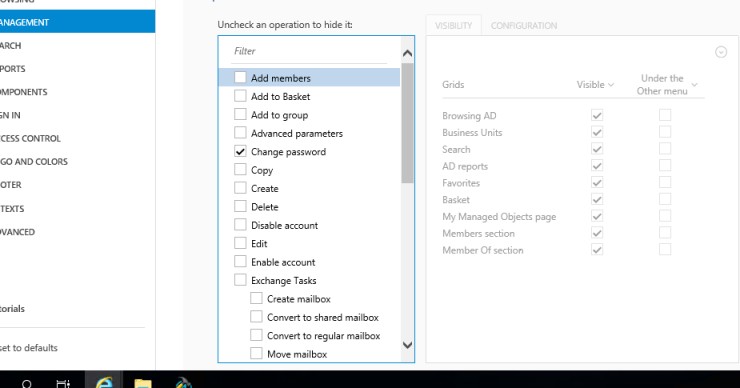

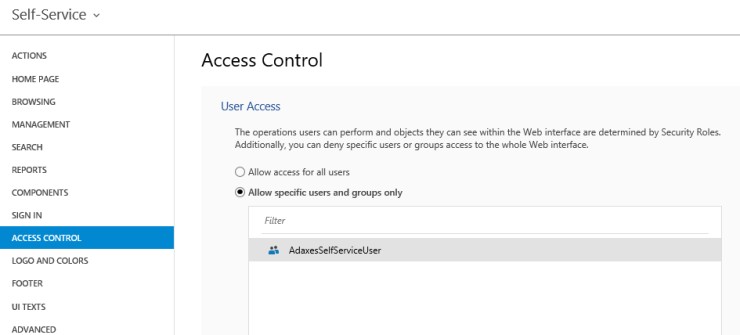

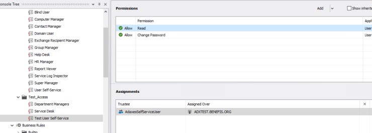

I tried to remove from the self service view in the management area:

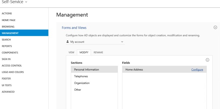

image.png I also set access on using a Adaxes security group. image.png And set the access in the web configurator. image.png Yet my test user can update the fields image.png

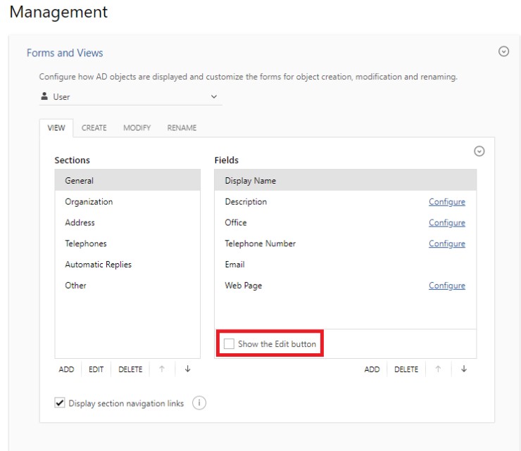

Thank you for clarifying. To achieve the desired, please, do the following:
by (1.2k points)

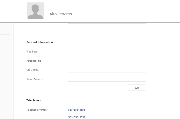

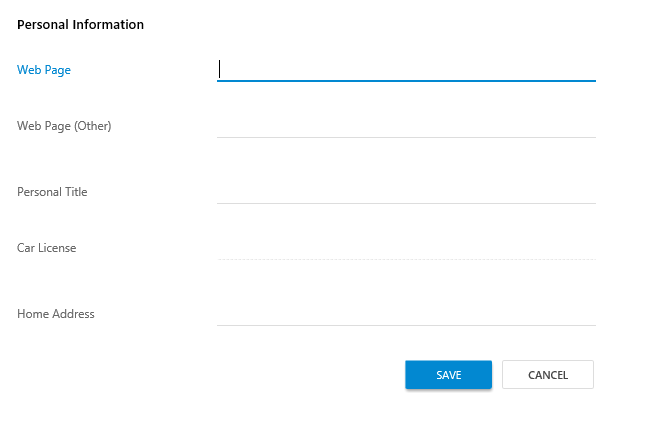

image.png image.png User still sees the edit button and can edit the properties. image.png
+1

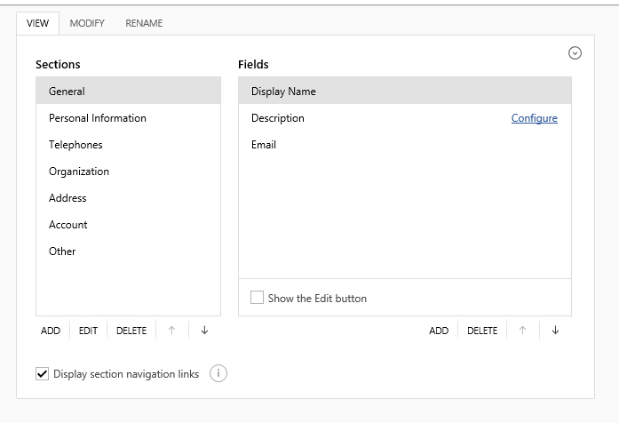

As we mentioned in the previous post, it should be done for all sections. According to your screenshot, the button was disabled for the General section, but is displayed for the Personal Information one.
by (1.2k points)
Perfect, thank you.
