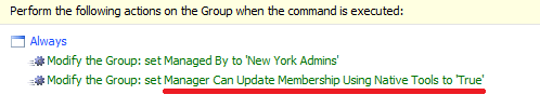

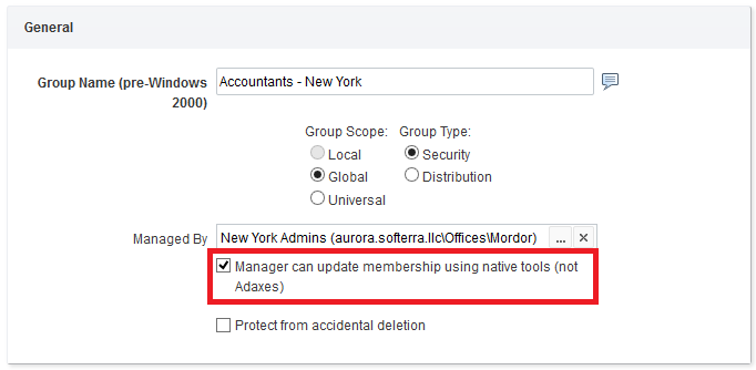

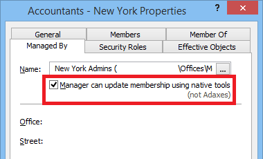

When you specify a user account or group to manage an AD group, you only specify the user / group in the Managed By property of the group they will manage. However, that is not enough for them to add/remove users to the group using native tools (such as ADUC, Outlook etc). You also need to assign them appropriate permissions in AD. To assign them, enable the Manager can update membership using native tools option:
  • In the Administration Console
  • In the Web interface
  • In a Business Rule, Custom Command or Scheduled Task
