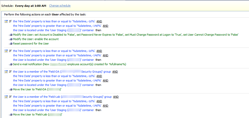

We are setting the hire date in the custom attribute (adm-CustomAttributeDate1) and we have the following scheduled task (see image)
We are trying to set this task to run every nioght at 9pm and send any users that start the next day or before.
Example: We could have 10 users starting tomorrow and 3 that started last week we were just notified about. We would like all 13 users to be affected by the task.

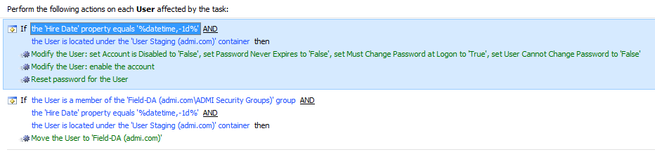

The condition If the 'Hire Date' property equals '%datetime,-1d%' means that the Scheduled Task will affect only users that have Hire Date set exactly to the same time (hours, minutes, seconds) on the day preceding the current one. You need to define a period for the Hire Date with two conditions. For example, for the Scheduled Task to affect users that have Hire Date between 10 and 1 days before the current the conditions should be as follows:

We set this up just like this (screenshot) and set a scheduled task time of 1:00am and the four people who should have been captured and completed by the task weren't touched.

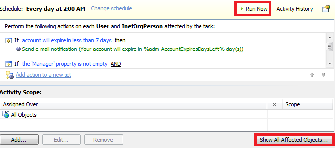

Could you make sure that each of the four user accounts meets all the conditions of at least one set?
Also, check if the Scheduled Task affects these users with Show All Affected Objects option.
Use Run Now option to execute the task out of schedule.

According to your Scheduled Task configuration, users that have hire date set to 2/27/2017 12:01AM will be affected by the task on 3/1/2017. The reason is that the Scheduled Task is executed at 1:00AM. For example, with the current configuration, the Scheduled Task executed on 3/15/2017 will affect only users that have Hire Date between 3/1/2017 1:00AM and 3/14/2017 1:00AM.
If you want the Scheduled Task to trigger on users that have Hire Date set to the previous day, the conditions should be as follows:
