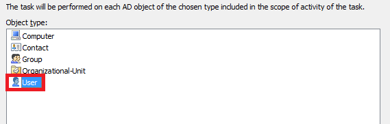

  2. On step 3 of the Create Scheduled Task wizard, select User.

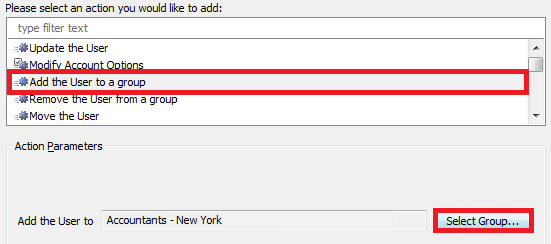

  3. Click Add Action and select Add the User to a group.
  4. Click Select group and select the group you want to add the user to, (Group 2).
  5. Click OK.

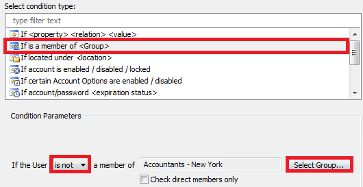

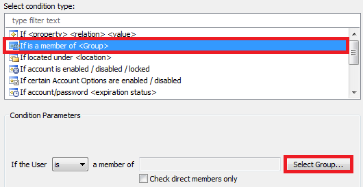

  7. Select If is a member of .
  8. Click Select Group and select the group a user should be member of (Group 1).
  9. Click OK.

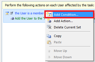

  10. Right-click the action you have created and click Add Condition.
  11. Select If is a member of .
  12. Click Select group and select Group 2.
  13. Select is not.
  14. Click OK.

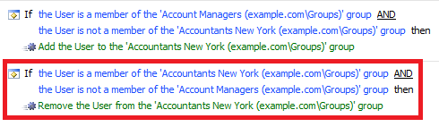

  15. If you also need to remove the user from Group 2 once they are no longer members of Group 1, click Add action to a new set and add the following:
    • Conditions: If a user is member of Group 2 and If a User is not a member of group 1.
    • Action: Remove a User from Group 2.
