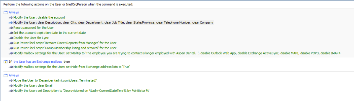

We are trying to get a scheduled task to run every Friday night at 10:00pm to pull the users needed to be fully deprovisioned by the custom command we have created.
by (3.2k points)
We have the following working perfectly and want to be able to run this as a scheduled task and pull users from a CSV file. Please advise.
You can do that using a script and a Scheduled Task. For details, see the following script in our Script Repository: http://www.adaxes.com/script-repository ... e-s402.htm.
Thank you this works perfectly.
