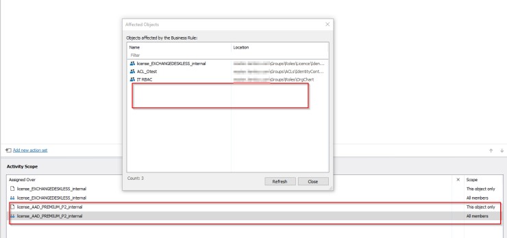

I have business rule that is NOT applied to group license_AAD_PREMIUM_P2_internal group even it should according activity scope. Scope for this group was added through PowerShell code mentioned here https://adaxes.com/sdk/DefiningScopeOfActivity/#example-4-include-a-specific-group-object-not-members-of-the-group
What can be the cause of this?

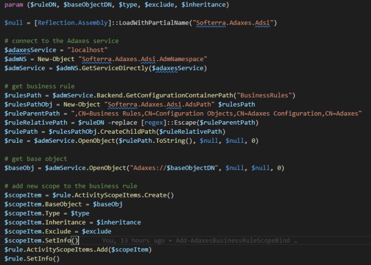

script + parameters:
$ruleADSPath = '<ADSPathOfTheAdaxesRule>'
$baseObjectDN = '<DNofTheADObject>'
$type = 'ADM_SCOPEBASEOBJECTTYPE_GROUP'
$exclude = $false
$inheritance = 'ADS_SCOPE_BASE'
$null = [Reflection.Assembly]::LoadWithPartialName("Softerra.Adaxes.Adsi")
# connect to the Adaxes service
$adaxesService = "localhost"
$admService = $admNS.GetServiceDirectly($adaxesService)
# get base object
$baseObj = $admService.OpenObject("Adaxes://$baseObjectDN", $null, $null, 0)
# get business rule
$rule = $admService.OpenObject($ruleADSPath, $null, $null, 0)
# add new scope to the business rule
$scopeItem = $rule.ActivityScopeItems.Create()
$scopeItem.BaseObject = $baseObj
$scopeItem.Type = $type
$scopeItem.Inheritance = $inheritance
$scopeItem.Exclude = $exclude
$scopeItem.SetInfo()
$rule.ActivityScopeItems.Add($scopeItem)
$rule.SetInfo()
I am guessing that problem is in the "save" action, but I've tried setOption() too without any luck.
Thank you for the provided details. The issue occurs because the $type variable is set incorrectly. As it is specified in the example you referenced, the variable must be set to ADM_SCOPEBASEOBJECTTYPE_CONTAINER. Changing the variable value will remedy the issue.
by (1.0k points)
You are right. Usage of ADM_SCOPEBASEOBJECTTYPE_CONTAINER indeed solved the problem.
Can you clarify why? Or maybe when should I use ADM_SCOPEBASEOBJECTTYPE_GROUP type?
From official documentation it is not very clear (at least for me)
+1
Whenever you need to add an item as this object only, the ADM_SCOPEBASEOBJECTTYPE_CONTAINER type should be used. The ADM_SCOPEBASEOBJECTTYPE_GROUP one should only be used when it is about group members.
Thank you for pointing this out. We will consider updating the documentation accordingly.
by (1.0k points)
aka
if ADS_SCOPE_ONELEVEL or ADS_SCOPE_SUBTREE use ADM_SCOPEBASEOBJECTTYPE_GROUP
if ADS_SCOPE_BASE use ADM_SCOPEBASEOBJECTTYPE_CONTAINER
is that correct?
