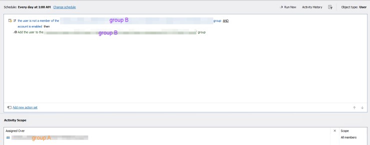

Let me explain my setup
  1. A rule-based group (A) is updated daily
  2. A scheduled task is running daily to copy members from group A to B

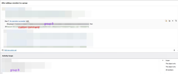

  3. A business rule is triggered against group B if a user is added
    1. The business rule is calling a custom command with a parameter
  4. The custom command runs a Powershell script against the added user and set a attribute to the send over parameter

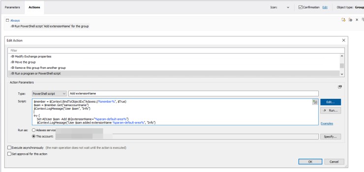

This is my PowerShell code
$member = $Context.BindToObjectEx("Adaxes://%member%", $True)
$sam = $member.Get("samaccountname")
$Context.LogMessage("User $sam", "Info")
try {
    Set-ADUser $sam -Add @{extensionName="%param-default-area%"}
    $Context.LogMessage("User $sam added extensionName %param-default-area%", "Info")
catch {
    $Context.LogMessage("User $sam added extensionName %param-default-area% failed due to the following exception: $($_.Exception.Message)", "Error")

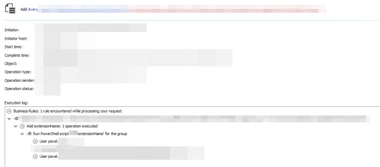

Hi, sure

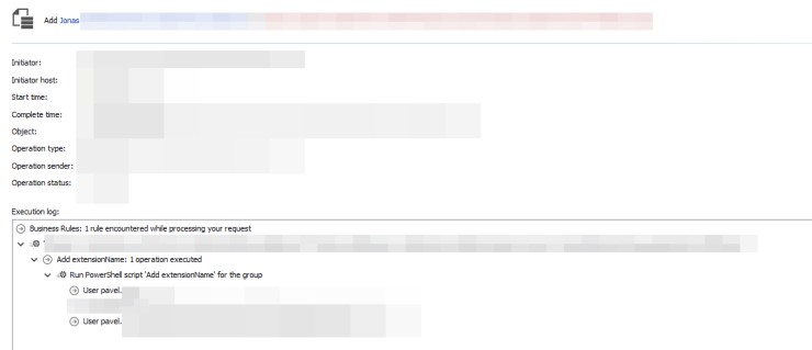

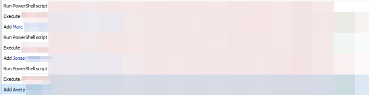

As you see, every time user pavel is used as variable in the script.
The script is shared in my first post already, hope this is ok and enough.
