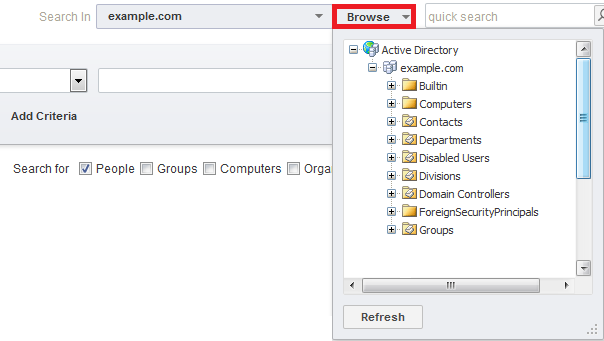

You can limit the search to a certain OU and its child objects. To do so:
  1. Activate the Search tab.
  2. Click Browse in the Search in panel and then click the OU.
  3. Enter the criteria and click Search.

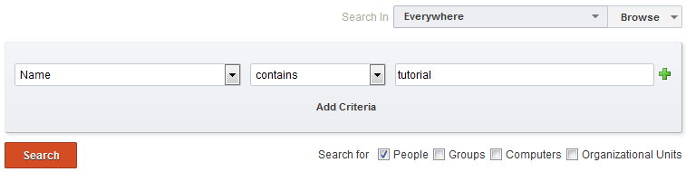

Could you post a screenshot of the search criteria you use? We need something like the following:

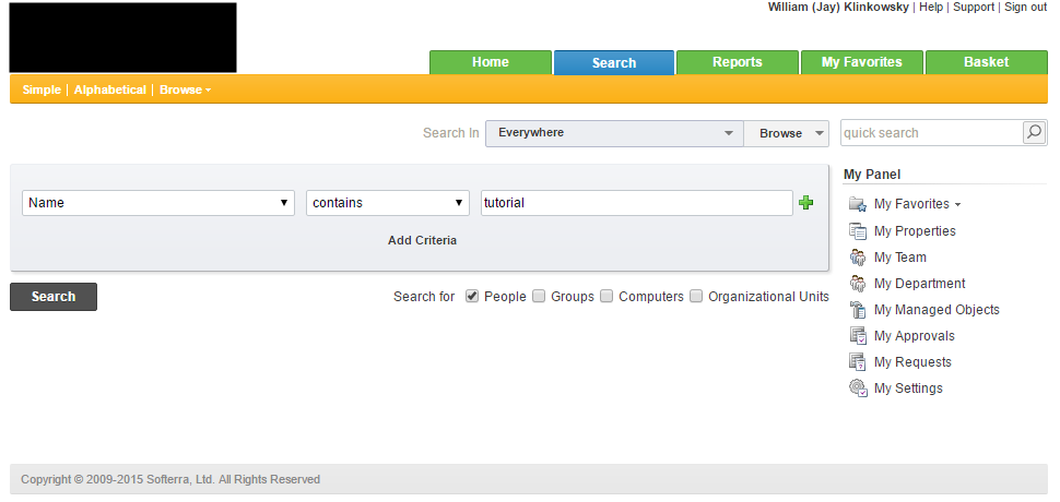

by (3.2k points)
by (307k points)
In your case, the search engine will check all the users in your environment. Thus the delay is reasonable. However, there might be some connectivity issues with domains. You can unregister them one by one and perform the search again. If the delay is the same, then it is caused by the quantity of users in your environment.
