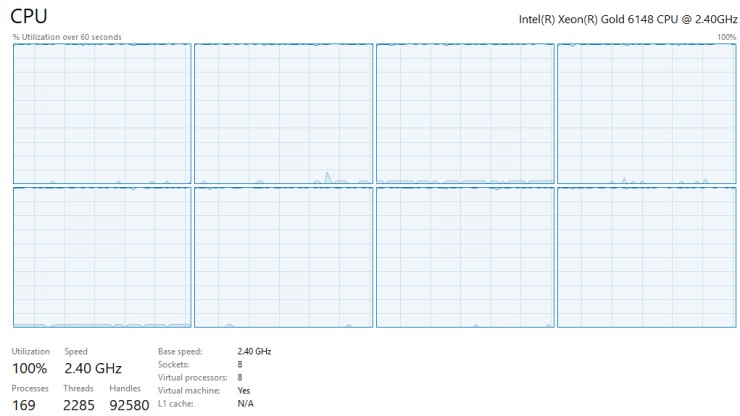

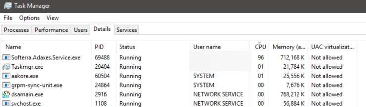

We have Adaxes (3.15.21009.0) set up in HA across 2 back end servers. I am just working on a simple script, connecting from a seperate box to one of the BE servers and noticed when I started the script it stopped responding.
On checking the BE servers, one is using between 2 and 10% CPU, the other is 100% with the Adaxes service account using over 90%. Is there any way to track what Adaxes is doing to help identify why the service is taking all the compute of this server? Adaxes CPU 1.png Adaxes CPU 2.png

Hello Matt,
You can try checking Adaxes general log and event log for detailed information on the currently running processes. However, your script might be calling something by means of Adaxes that increases the CPU usage and that is not reflected in Adaxes logs.
