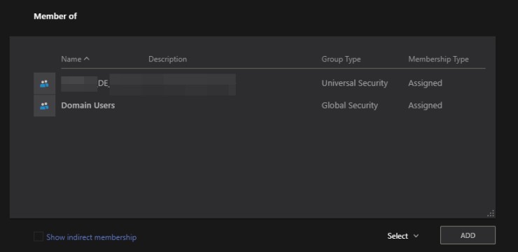

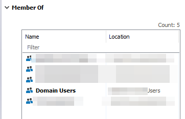

by (2.7k points)

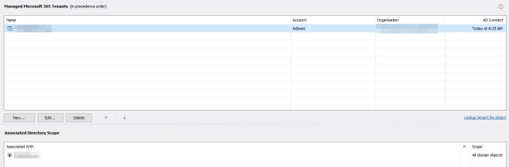

by (2.7k points)

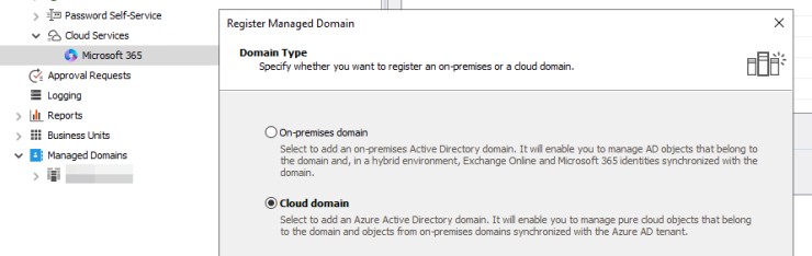

As it is mentioned in the article we referenced, registering your Microsoft 365 tenant in Adaxes does not provide access to cloud-only objects. You need to also register your Azure AD domain for that. The domain should be present under the Managed Domains node in the Administration console.
by (2.7k points)
after adding cloud domain to managed domains and running script again, all goups incl. online ones were removed and user was also removed from any MS Team he was member of.
