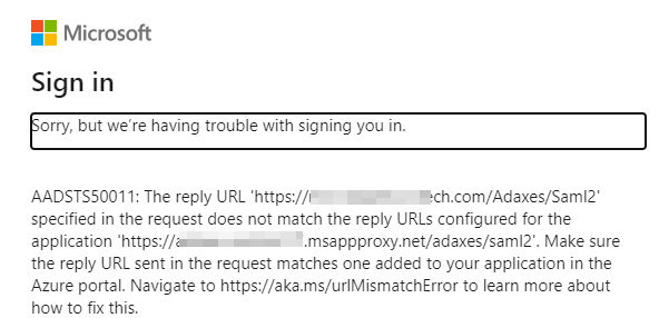

Actually, maybe I spoke too soon! The SSO works when testing via the app proxy SSO configuration, but when trying to load the site in another browser or having signed out, I am back to getting an error. image.png
The first URL is my internal domain and isn't configured anywhere in the Adaxes sign in settings or Azure app proxy.

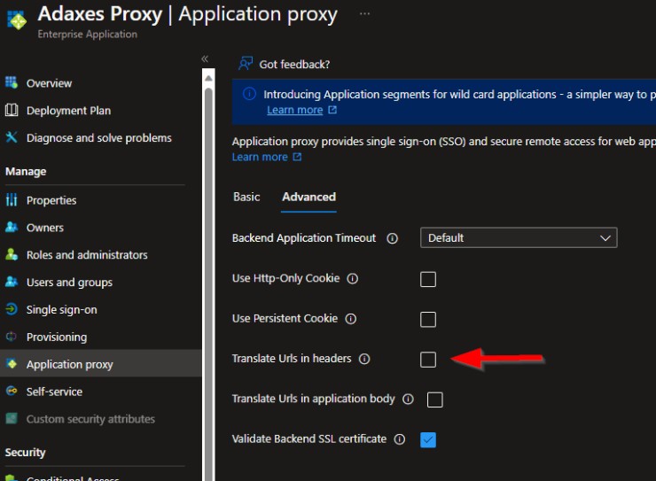

Hi
I was talking about this with a colleague yesterday and we've managed to get it working (thanks Paul).
The SSO over Azure will work fine using either the msappproxy.net or a custom domain, provided that the "Translate Urls in headers" app proxy option (under the Application proxy / Advanced settings) is unchecked. image.png
Having looked at the info for this option, (it's a little wooly IMHO) when it's enabled it will try to translate the AAP URL into the internal URL once the authentication is completed, hence the issue I was seeing. I still don't understand why the tests were working from the "Test this application" option of the SSO config, but that's an issue for another day.
