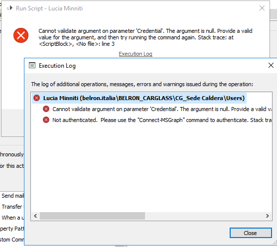

Before authentication with azure our custom command like:
$m365Credentials = $Context.GetOffice365Credential() Connect-MSGraph -Credential $m365Credentials Get-IntuneManagedDevice | Where-Object {($.emailAddress -match "%mail%") -and ($.operatingSystem -eq "Android")}
works well, now without credential how should i modify the script to make it work?

Hello Simone,
What exactly do you mean by without credential? Could you, please, describe the desired behaviour in all the possible details with live examples?
by (500 points)
After the authentication with azure, if I try to run the script, I received this error:
Hello Simone,
Thank you for clarifying. This behaviour is by design when your tenant is registered using credentials of an Azure AD app. For examples on how to establish connections in your scripts, have a look at the following SDK article: https://adaxes.com/sdk/CloudServicesScriptContextClass.
