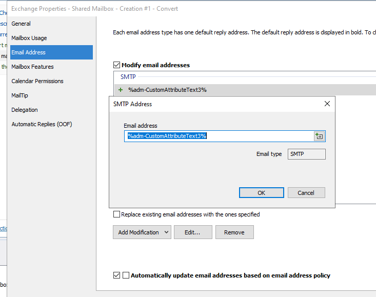

I am trying to set a primary smtp address to a user based on input during creation. If someone set a specific email in form, this is stored in customAttributeText3 and set to mailbox later: image.png
Based on email type its SMTP (lowercase letters). From my knowledge capital SMTP address is the primary one.

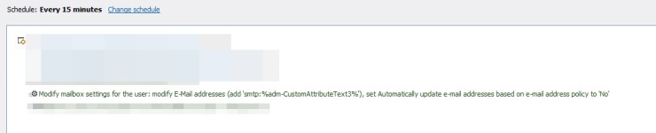

The action after saving shows smtp (upper case letters) and the email address is also only added as alias and not set as primary. image.png
How can I set a specifc email address as primary? Do I need to run a PS command to set it?

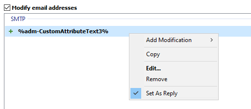

nvm ... found the option :D
Rightclick gives you some more actions

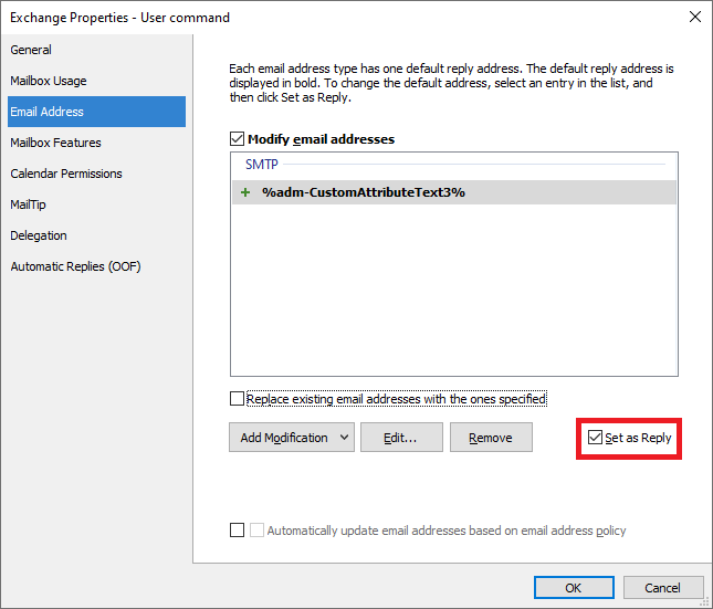

There is also a dedicated option available on the right below the list of address modifications. image.png The option is available when you select an address in the list and the Replace existing email addresses with the ones specified option is disabled. If the option is enabled, the first added address in the modifications list is set as primary automatically.
