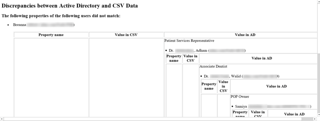

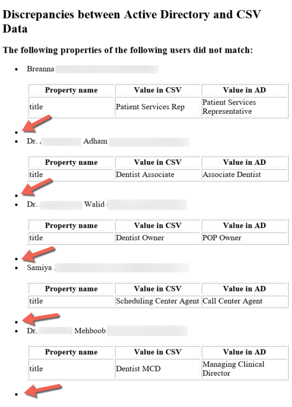

excellent, it looks better. We just have an extra bullet before each person
Could you provide us with a screenshot?
by (3.2k points)
See attached screenshot. Extra dots are pointed out in red arrows.
We have updated the script for you. Find it below.
