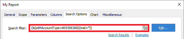

  6. In the Search filter field, enter the following: *(&(sAMAccountType=805306368)(mail=))** image.png

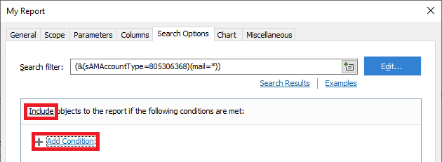

  7. Make sure that the option for the report conditions is set to Include (click Exclude if set).

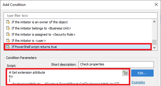

  9. Select If PowerShell script returns true.
  10. Paste the below script into the Script field.
# Get extension attribute
    $extensionAttribute = $Context.TargetObject.Get("extensionAttribute15")
$Context.ConditionIsMet = $Context.TargetObject.Get("mail") -ne $extensionAttribute
  2. Click OK twice.
