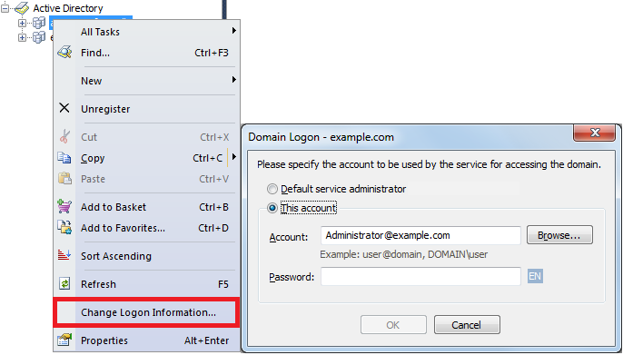

  4. Check user account specified during the domain registration. To do so:
    • Launch Adaxes Administration Console.
    • Expand Adaxes service node and then expand Active Directory node.
    • Right-click the domain and click Change Logon Information.
    • Check roles assigned for the user in Exchange. To do so, check the following article: http://msexchangeguru.com/2015/12/18/rbac-2016/.
