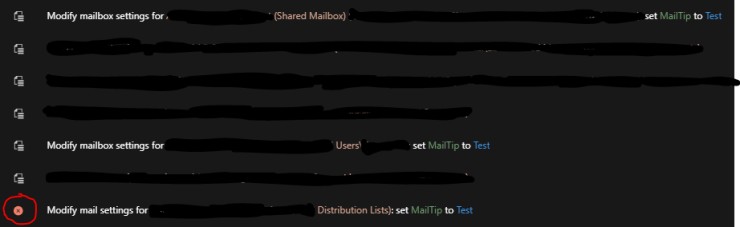

I noticed it appears that only AD Distribution Lists are the objects having issues, noting that I can change the MailTip Manually for example, only on users and shared mailbox accounts, but not Distribution Lists. As you can see it failed for the Distribution List: image.png

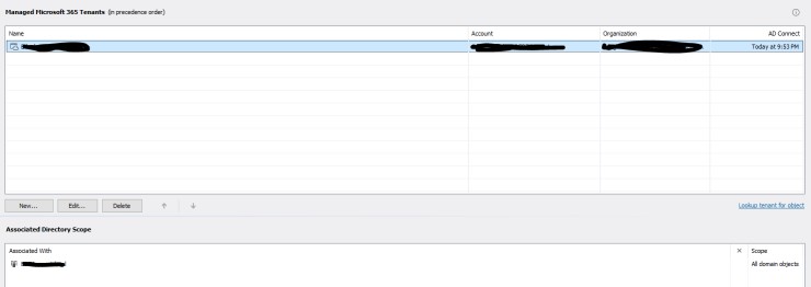

I have connected my Cloud Tenant using User Authentication, and not as an Application, against a service account with Global Administrator Permissions: image.png

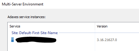

  • Post here or send us at support@adaxes.com a screenshot of the Multi-server environment dialog. The dialog displays how many Adaxes services you have and what their versions are. For information on how to view it, see https://www.adaxes.com/help/MultiServerEnvironment.

I only have 1 Instance: image.png
Here is the output of a successful Mailtip Change on a User/Shared Mailbox:
"[12/19/2023 18:31:50] Set-Mailbox -Identity "Identity ID Removed" -MailTip "test" -Force "True"
[12/19/2023 18:31:51] Succeed"
Here is the output of an attempt at changing the Mailtip on a Distribution List:
[12/19/2023 18:32:34] Get-DistributionGroup -Identity "Identity ID Removed"
[12/19/2023 18:32:34] Succeed
[12/19/2023 18:32:34] Set-DistributionGroup -Identity "Identity ID Removed" -MailTip "test"
[12/19/2023 18:32:35] System.Exception: |System.InvalidOperationException|The operation on Identity "#AllEmployees" failed because it's out of the current user's write scope. The action 'Set-DistributionGroup', 'MailTip', can't be performed on the object 'TestDL' because the object is being synchronized from your on-premises organization. This action should be performed on the object in your on-premises organization.
   at #Dh.#Jh.#l.#5w.#VZc(RunspacePool runspacePool, PSCommand psCommand, String[]& warnings)
   at #Dh.#Jh.#l.#5w.Execute(#Gh command)
   at #Dh.#Fsf.Execute(#Gh command)
   at #ik.#hXe.Execute(#Gh command)
by (17.0k points)
Thank you for the provided details. The behavior is expected and is not related to Adaxes itself. The thing is when you create a distribution group with an email address, the Microsoft Entra Connect (former Azure AD Connect) utility synchronizes it and the group becomes a distribution list in Exchange Online. However, the group is considered as synchronized from on-premises, as such it must be managed in on-premises Active Directory. But if the on-premises Active Directory schema is not extended with Exchange properties, it is not possible to modify the Exchange properties either in Exchange Online or in the on-premises Active Directory. To be able to modify the Exchange properties of synchronized distribution groups, your on-premises Active Directory schema must be extended with Exchange attributes.
