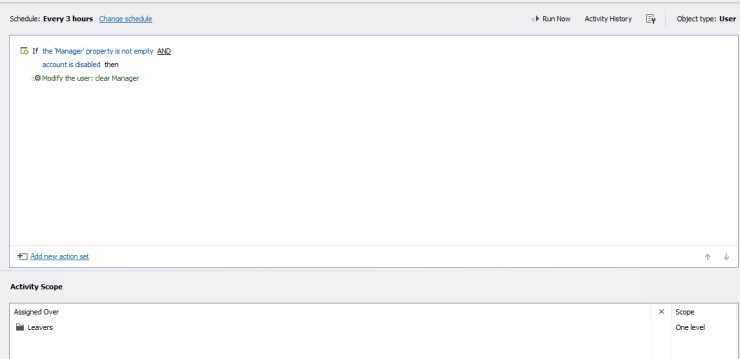

I am trying to clear the manager of disabled accounts and created a scheduled task for this image.png

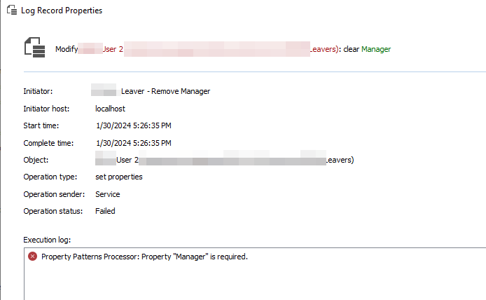

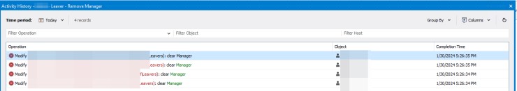

With error message
Property Patterns Processor: Property ''Manager'' is required.
Any clue? I tried this also during update/business rule but same error. Then I created this task but it won't also remove/clear the manager.
All user still have the attribute set.
by (2.7k points)
The behavior is expected as you made the manager property mandatory in Adaxes via property patterns. The following tutorial will be helpful: https://www.adaxes.com/help/MakePropertyRequiredAndSpecifyFormat.
by (2.7k points)
Well spotted ... I had the scope setting with subtree and the Leavers OU was included.
Excluded the OU and working well!
Thanks : )
