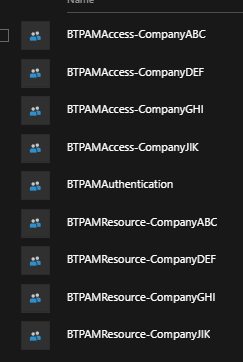

In this specific example, we have 3 different groups. 1 for Access, 1 for resource, then one for authentication. Each company has a Resource and Access Group.

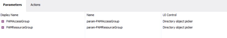

I already setup paramaters for the end user to select the resource and access group: image.png

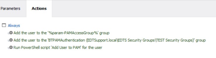

The selected user will be added to the access group and authentication group using normal commands: image.png

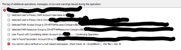

Script seems to be logging the expected information. User I am running the script under does have a secondary account. It finds it just find, but I cannot seem to understand the simple script I need to add for it to add the secondary account to the selected resource group (If Found.) If not, I already have a log message included to state one was not found.
