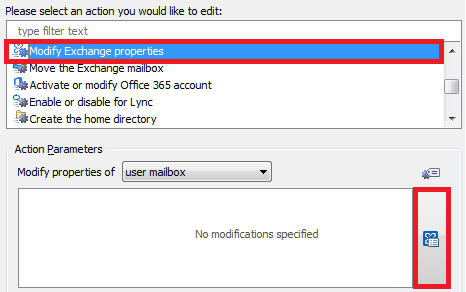

To achieve this, you do not need a script. You can do it using our built-in Modify Exchange properties action. To add the action to your Custom Command, Business Rule or Scheduled Task:
  1. Select Modify Exchange properties.
  2. Click Exchange properties button.

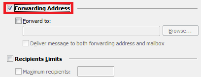

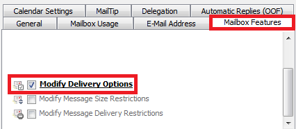

  3. Activate the Mailbox Features tab and select Modify Delivery Options.
  4. Select Forwarding Address.
  5. Click OK three times and save the changes.
