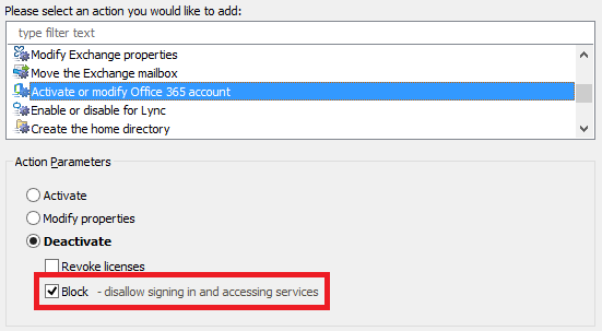

That's a question more to Microsoft Support than to us, because it is not quite clear as to what the setting may take up to 60 minutes to take effect wording means. On Adaxes part, as soon as you enable Litigation Hold for a mailbox, Adaxes sets the LitigationHoldEnabled attribute of the mailbox to TRUE via PowerShell. Everything else is done by Exchange. We didn't test such a scenario, but from our point of view, a safer approach would be to leave the users within the AAD Scope, but block their access to Office 365 services.

Yes, that's possible. Try re-checking the things after the ticket is closed by Microsoft or using a different Office 365 administrator account in your tenant settings.
