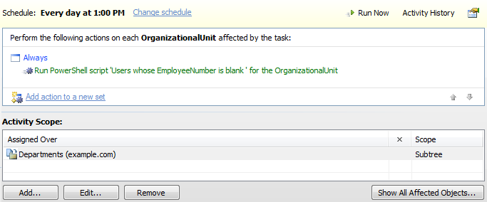

Hello Ben,
What exactly does not meet your requirements in using a Scheduled Task and the script as we suggested in our previous posts?
If you create a Scheduled Task configured for Organizational Unit object type, there will be only one email notification sent by the script for each OU in the Activity Scope of the task. The notification will contain a full list of all users in the OU with blank property.
by (490 points)

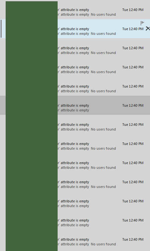

Ok, I thought that also but when I set up the scheduled task...set it to run over one OU where we have about 50+ user objects with missing EmployeeNumbers, I received one single email for each user who had a missing EmployeeNumber, and emails that contained no data. You can see from the image below that some are blank, and some contain single lines with Full name and Logon name. Thanks again for the help on this.

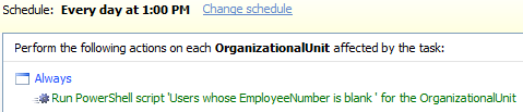

Could you provide us with a screenshot of the Scheduled Task you have created with the Activity Scope? We need something like the following:
